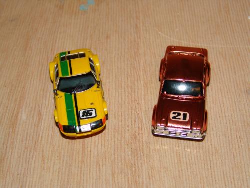

[attachment=133:attachment]Hallo Slot Freunde
